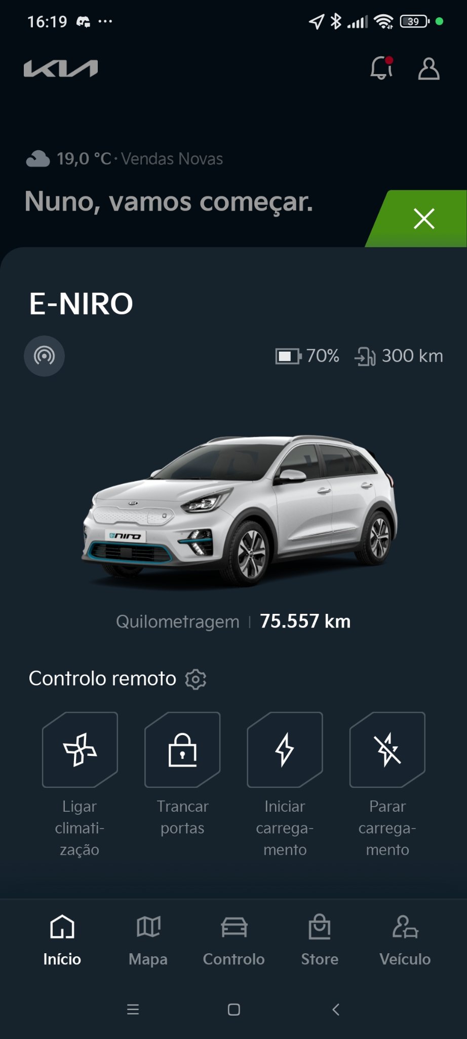

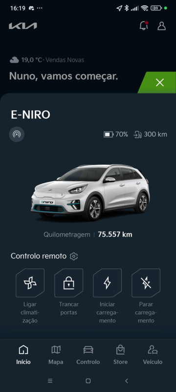

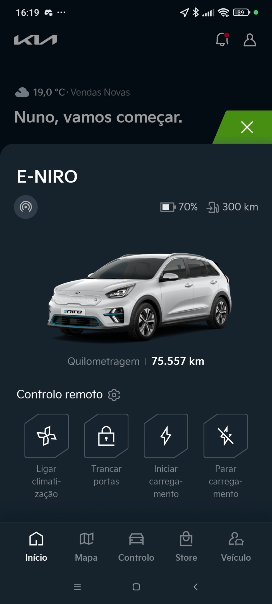

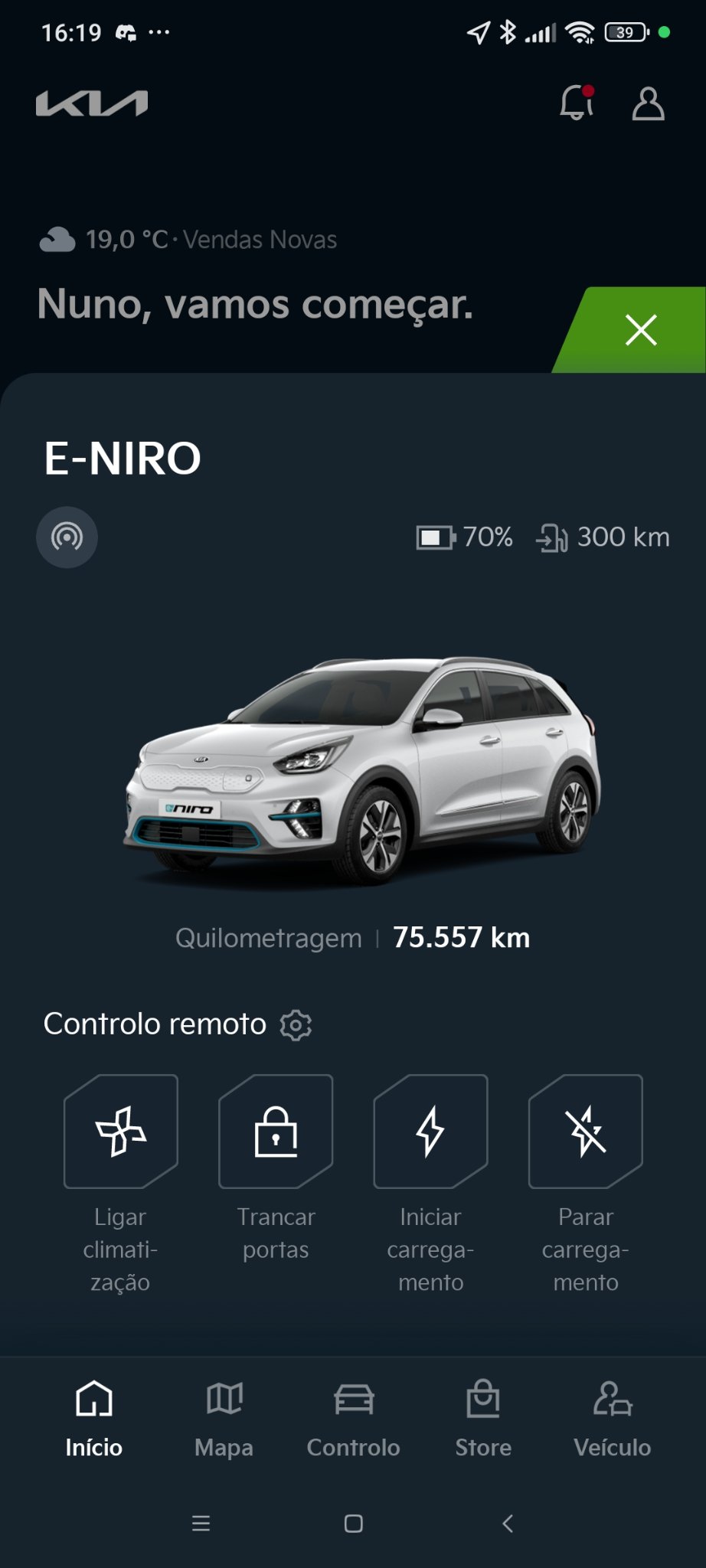

Alguem com problemas a conectar app kia ao carro
A 14 dias que nao connecta (nenhuma resposta do servidor ERRO KG-1001)
1. Perform an Infotainment "Soft Reset"This is the most effective quick fix to refresh the modem.Locate the pinhole: Look for a small pinhole button on the dashboard near the volume knob or media controls.Reset: Use a paperclip or similar tool to press and hold this button until the screen goes black and restarts.Wait: After the system restarts, allow about 3 minutes for the modem to re-establish connectivity.
2. Reconfigure the Network in VehicleIf the reset doesn't work, manually reconfigure the connection:Navigate to Setup > Kia Connect (or UVO) > Data Network.Select Reconfigure to force a synchronization with the server.
3. Clear Cache/Re-login on AppSign out of the Kia Access App.Clear the app cache in your phone settings.Log back in and attempt to refresh the status.
4. Check for External IssuesWeak Signal: If your car is in a garage, try moving it to an open area to get better cellular reception.Subscription/Terms: Ensure your subscription is active and you have accepted all privacy terms in the app.If the error persists, it may be a temporary server issue or a need for a deeper, dealer-level update. According to User reports on Reddit, if the issue continues for several days, you may need to call Kia Connect Support to have them refresh the account on their end.
Mensagens: 3850
Re: Diario de Bordo TVDE EVUBER E-NIRO 64kWh
Aqui tudo normal.
EVUber
Mensagens: 246
Registado: 10 nov 2021, 22:35
Capacidade bateria: 69kWh
Mensagem por EVUber »
ja resolvi
o Infotaitment precisava de ser actualizado para nova versão....e que grande filme...
No mac precisei de 110gb livres para o navigator da kia fazer download da versão
Ainda estive de andar a limpar cache e ficheiros purgáveis para o software da kia identificar que tinha espaço
Depois o carro tem USB o computador tem usb-c, va la tinha aqui um leitor de cartões USB antigo e usei micro sd card.
